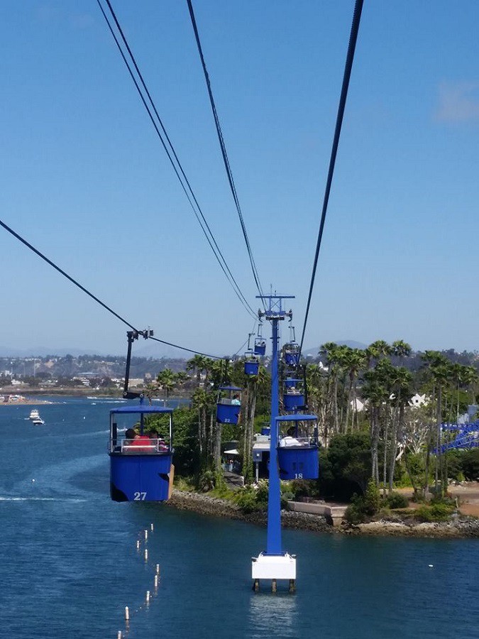

Thank you Rodo for this incredible report! Note that the capacity can be adjusted based on the crowds.
Merci Rodo pour cet incroyable reportage ! Notez que la capacité peut être ajustée en fonction de la foule.

I think Robbie Von Roll will send use more informations about this gondola !
#4 L'utilisateur est hors-ligne   Rob Von Roll
  • Messages : 12
  • Inscrit(e) : 28-juillet 18
Posté 29 juillet 2018 - 17:13
Hello.
Nice report.
Tower batterys are the 16 sheave tower batterys . Very first Von Roll VR 101 to have 16 sheave tower batterys. Cable diameter is 31 mm. The largest cable diameter of any VR 101.
Span between towers is 925 feet..The ONLY VR 101 that has this massive span.
Fastest VR 101 ever built 8.7 mph.
Only Von Roll VR 101 left to go over a body of salt water.
Motor 85 hp Brown Bovari 620 v. Original motor from 1967!!!
. This is my home ride. I worked on this ride for many years.
#5 L'utilisateur est hors-ligne   Rob Von Roll
  • Messages : 12
Posté 29 juillet 2018 - 17:41
Heaviest counterweight of any VR 101. 50,000 lbs.
Counterweight track ropes 45 mm.Fatzer.
Max capacity 25 cabins at 12 second intervals
1967 Max capacity 30 cabins at 7 second intervals.
